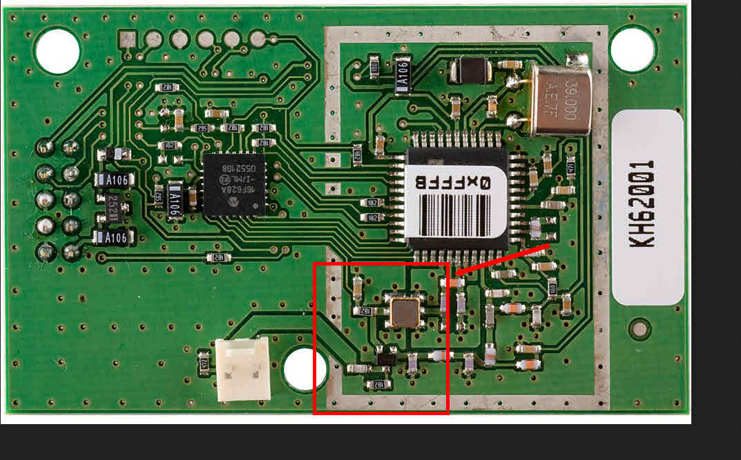

I would suspect 2 things.
Connection between antenna and the base modul are have some hf problems. The preamplifier of the 82R is defective.
Do you have you restart the EMA?
Can you meassure any changes in monitoring the rf level after restart?
If you have knowledge in electronics have a look at the preamp section (see attached picture).
If not it seems you must probably exchange the 82r with a newer one.
regards Chris

I had a look in the preamp section. Only two components are semiconductors.
Bandpassfilter and dubble diod.
No obvious fault. I i had a spare i would change them but i don´t.
Regards Jim

Check if all components on the systemboard seats correctly.
This step may only be done when the systemboard is completly offline.
No battery is connected and the AC plug is off.
This is very important.
As you can see in your case the board has not much components.
One controller one flash chip some passive parts in the preamp section an preamplifer.
Don't know the label on the chip.
But this one is the only thing for me which would explain the low RF-Level.
On the other hand it is easier to buy a new one.
Otherwise I don't know what we could do else.
Regards Christian

Finally i reicived a new JA-82R pcb board.
This solved the problem.
Compared Old and new pcb components with VI signatureanalysis and it show one small difference.
It seems to be connected directly to the 28 pin IC. If this is the case htesr is not much to do with the old PCB.
